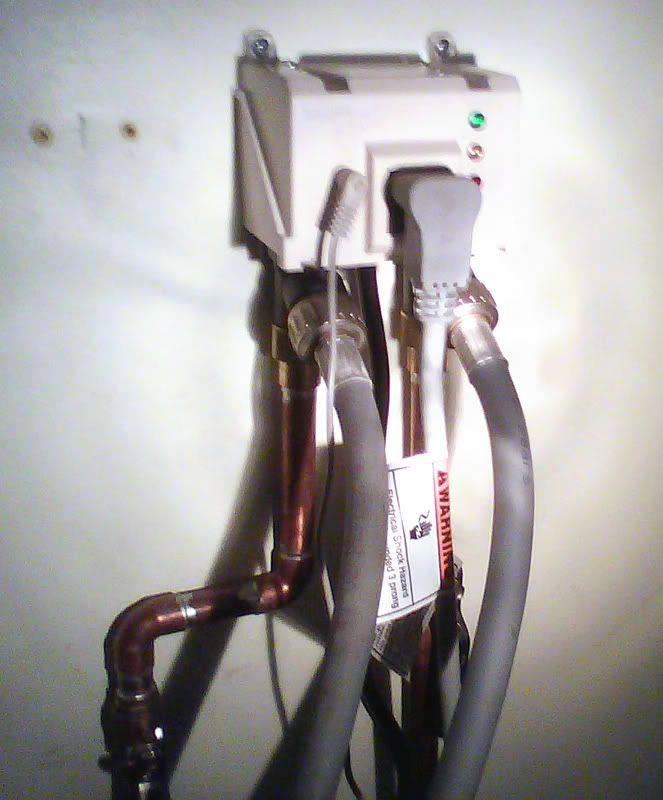

I landed a job with a condo association installing Watts A2C Intelliflow Automatic Washing Machine Shutoff Valves in the units. They had suffered numerous water damage claims from leaking washing machines and burst hoses in the past.
Several years ago they wanted the Watts FloodSafe Washing Machine Hoses installed based on the recommendation of their insurance company loss prevention specialist. I had recommended against installing the hoses as the supplied water pressure was borderline high (75 psi) and would cause false trips. I had also told them that the hoses offered no protection from leaking washing machines as well. But what does a plumber know compared to an insurance company loss prevention specialist? :whistling2:
So after a couple of years of people complaining about the false trips, people removing the hoses and changing them out to regular hoses, and several more water damage claims from leaking washing machines, they called ready to go with the plumber's recommendation.... :thumbup:
Here are some crappy pics from my phone, wish there was a flash as the lighting by the washers are terrible... Used my Flashlight to get the pictures...
They were using separate valves so I had to move the supplies closer together. Also installed 1/4 turn ball valves on the hot and cold supplies to isolate the washing machine valves.

They do both...
The water only turns on when the washer is running. When you first activate the unit the automatic valve calibrates to the washer and even those that draw a current when off can be used. The sensor calibrates to the standby current draw then turns on the valve when additional current is drawn.
There is also a sensor that goes in the pan or, on the floor, which will detect water and shut the valve down.
These are older condos and they had numerous water damage claims, They had initially required the FloodSafe braided stainless steel hoses but had many complaints of false trips and many of the residents had removed them. They also had additional claims from washer standpipes overflowing, leaking machines, and damaged pans. They have a fairly high property turnover and the movers were not always careful in placing the washers in the pan damaging them.
