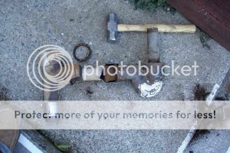

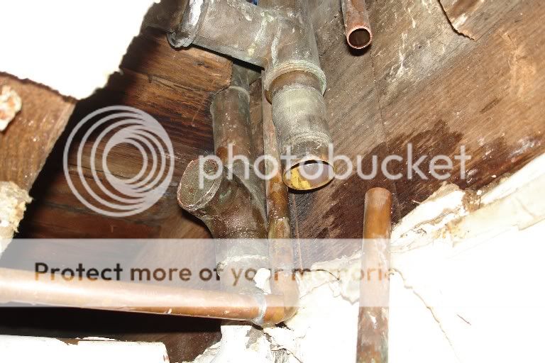

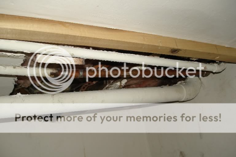

Got call water dripping from ceiling below tub on second floor (bad tub shoe gasket and slip nut gaskets) I go ahead and cut the sheetrock and to my surprise there’s the old ci trap for tub that’s still tied in to sanitary un capped. (the newer waste was a 1 1/2" copper) so in order to replace slip nut gaskets I had to cut out the brass trap every thing seemed up to code vent seemed fine till I noticed it terminated 6" behind tub so basically I had to rework everything and install proper vent and tie into ci stack on exterior of unit pain in the :censored: ass so anyways here’s the pics
before
old ci trap
everything seemed okay till i ran my flash lite up there and saw un capped 1 1/4" vent terminating behind tub (hacks!!:censored:)
ci drain sealed dont laugh at my lead joint i couldn't find my runner so i used a rag soaked in cutting oil

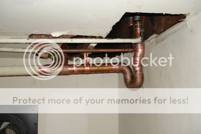

Finished product
i forgot to take pics of the vent tie in to the stack..:rolleyes:

Are those tubular compression joints on the w/o? I didn't think you could install those in a concealed space like that. Is that a san tee or a combo? I don't work with copper dwv much so I can't tell. Looks like a combo to me.
752 Posts
Discussion Starter · #13 ·
those are slip joint compression fittings they can be installed in concealed spaces tubs only though / thats a combo (below the flood rim requires combonation fitting for venting)
