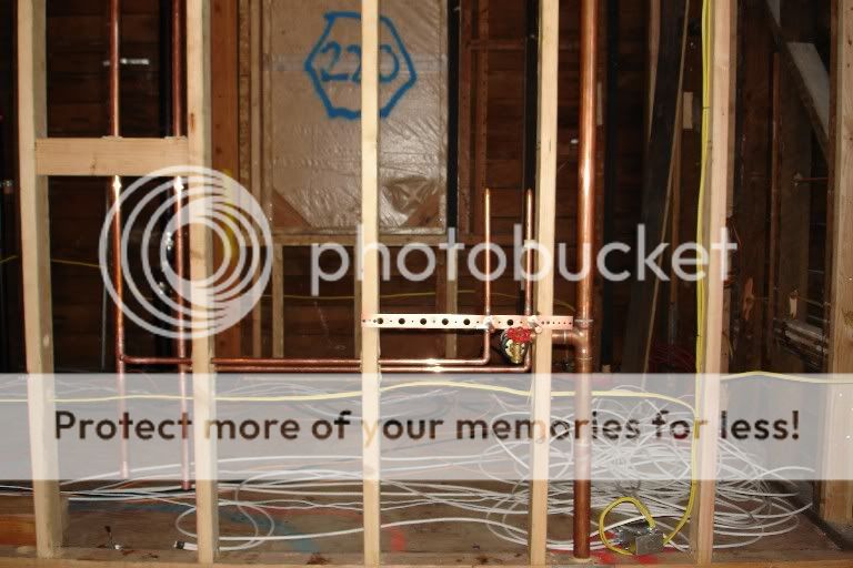

Hope you have a guard dog watching over the place with all the copper in there, copper thief's are out there.
Looks Good
Certified Lunatic
20,658 Posts

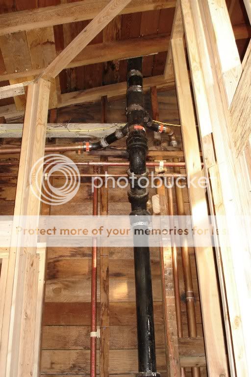

i like your island vent with the 90 and 2 45's. nice work
Yea but an AAV woulda worked!:laughing:
Say what's that smell in the kitchen...
Smells like a septic tank...
Nice work! I'd let you plumb at my house!:thumbup:
356 Posts

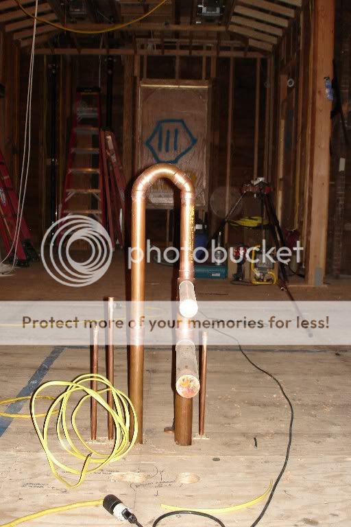

im wondering why you dont just install water hammer arrestors rather than run the extra copper tubing above.
356 Posts
the problem i have with the copper tubing hammer arrestor is that eventually they will just fill up with water and be completely useless. By code we arnt even allowed to do that anymore here.
Banned
8,808 Posts
I don't recall the last time I installed an arrestor, there used in commercial apps all the time. It is in our code but never enforced for residential work.
