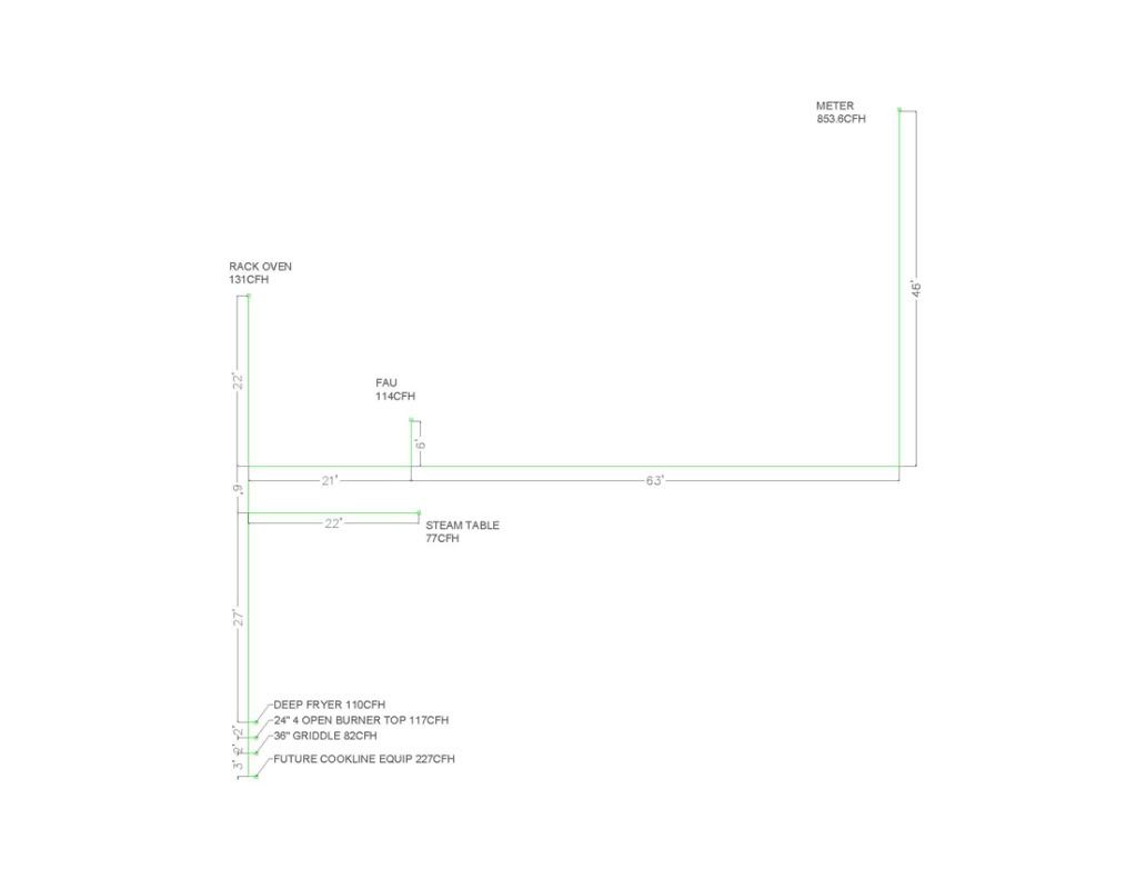

Anyone care to size this gas system out. I would love to see what others are coming up with because a very similiar system was installed in 2005 and the sizing was completely different than what I came up with. I was just curious what others would come up with.
Thanks for any help!:rolleyes:
using 2006 UPC, table 12-8

Natural or propane? I add up 858 CFH not what you have at meter on drawing. What type of material is pipe? Finally, what pressure at meter?

It is Natural Gas, 8" Water column, Black iron pipe.
Use table 12-8 for the pressure, it will be a 1/2lbs gas meter.
Sorry about the bad total, excel was using decimals, hehehe.:eek:
Heres my layout...
