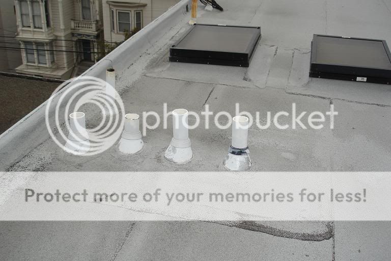

This is exhaust and intake piping for two munchkin boilers (made by heat transfer products in MA) in a residential duplex. The owners had issues with the the boilers not lighting off properly and the flue eco switch tripping and lockout errors leaving the building without heat and hot water.
I went out on the roof where these terminate and instantly knew the lighting off issue and excess corrsion inside boiler cabniets. The fact the original installer did not stagger the intake and exhaust to prevent flue gas recirculation let alone install proper fittings on the make up air either.

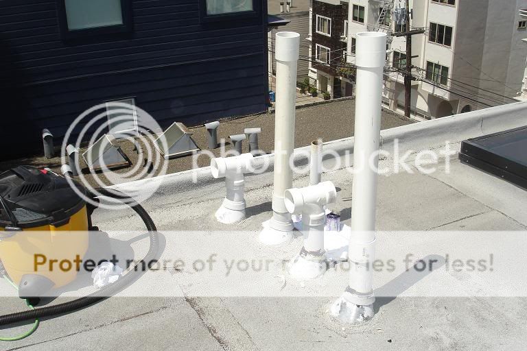

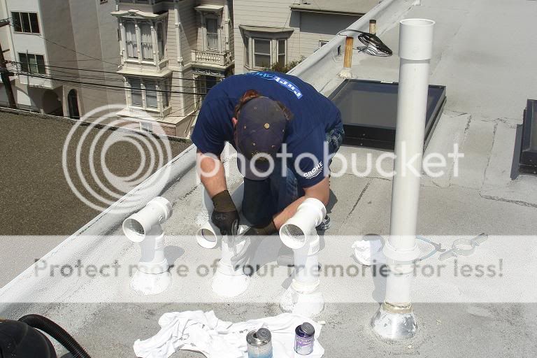

We installed manufactuer recomended intake tees to prevent rain water and debris from going down into the boiler cabniet. Both exhausts also did not have stainless derbris screens installed and we found all kinds of debris such as leaves and pieces of roofing paper and wood obstructing the flue and causing them to overheat.
The solution was to vacuum out all the debris from exhaust and intake and properly stagger vents and install stainless steel debris screens and replace flue ecos..

the intakes are the san tees and the exhaust is the longer risers the exhaust has to be above the intake by 2' to prevent flue gases from being sucked back into the gas valve and starving the boiler of fresh oxygen. Proper intake and exhaust is one of the more crucial things to look out for when installing these mod con boilers proper length and sizing etc.
