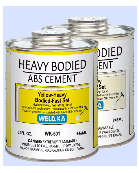

Yep, there are a lot of things different in the codes north of the border. I do however pay attention to what they do because it is interesting to compare the differences...
Things like yellow ABS Cement, kitchen sink traps under the floor, venting between floors are just a few of the differences...

We can't wet vent between floors and we also have a maximum fall on a drain before the trap.
And we have black ABS cement...
